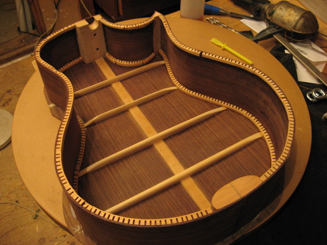

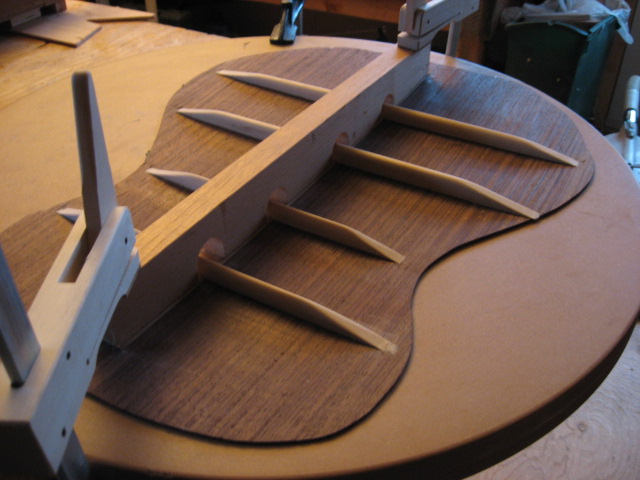

Here I've glued in the centre strip.

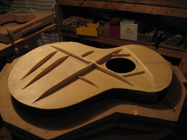

Top braces glued in. Note: a few pieces missing here and there...

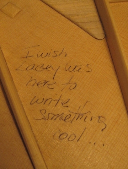

A little message inside...

Nice message!

Looks cool buddy. Super clean looking. I like your center strip jig. I have been gluing in my center strip then chiseling it out to fit my braces. Your way of doing it looks like a good idea to me.
I also like your shape. The cutaway is very cool. Put up more pics when she is all together.

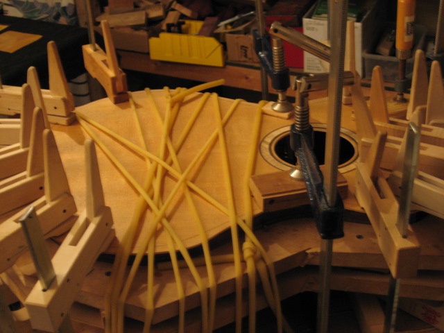

Thanks for all your kind words folks!
Rod, I've tried it just to glue on the plates. I use HHG for most everything else. Well, the blocks still get titebond... I figured that I wanted the glass hard cured glue but I'm not quick enough with HHG (don't ask me how I know this... )
Homeboy, that's how I did it before but from now on, it's going to be braces first for me. You have full access to the braces while shaping them and if you take your time, you can get a compression fit with the back strip pieces. I used that caul (which has a bottom radius of 15') to align the strip while gluing it. I used HHG so I just held them in place for a minute or so by hand, then I placed the caul on top.
Hesh, parabolii indeed! Pretty much the same as I used on no.2. You can't tell from that picture, but those are very skinny braces.
I was going to cut off the excess at the cutaway before gluing the top on, but I decided to use a bunch of cam clamps in a 'dry' run (as opposed to just clamping at the blocks and roping the rest) and I figured I didn't need to... Now that I think of it... cutting that off with a jig-saw on the guitar is probably asking for trouble... hmmm...

Alain, what I've done on all of my guitars is use a hand held coping saw to get the cutaway area out, than just route flush. Actually on the last one, I just routed it out with the flush cutting bit.
The reason that I leave the excess on (both back and top) is that I have a friend who I'm helping build a guitar (blind leading the blind ) and after he finished installing a really nice back strip, he cut the plate out to shape, but cut it out backwards and now the cutaway was on the wrong side of the guitar. Needless to say, the world will never see his nice back strip, thankfully the EIR was a nice book match and looks great all on it's own. Another hard leason learned, but I still don't trust myself to cut it out before it's on the body
